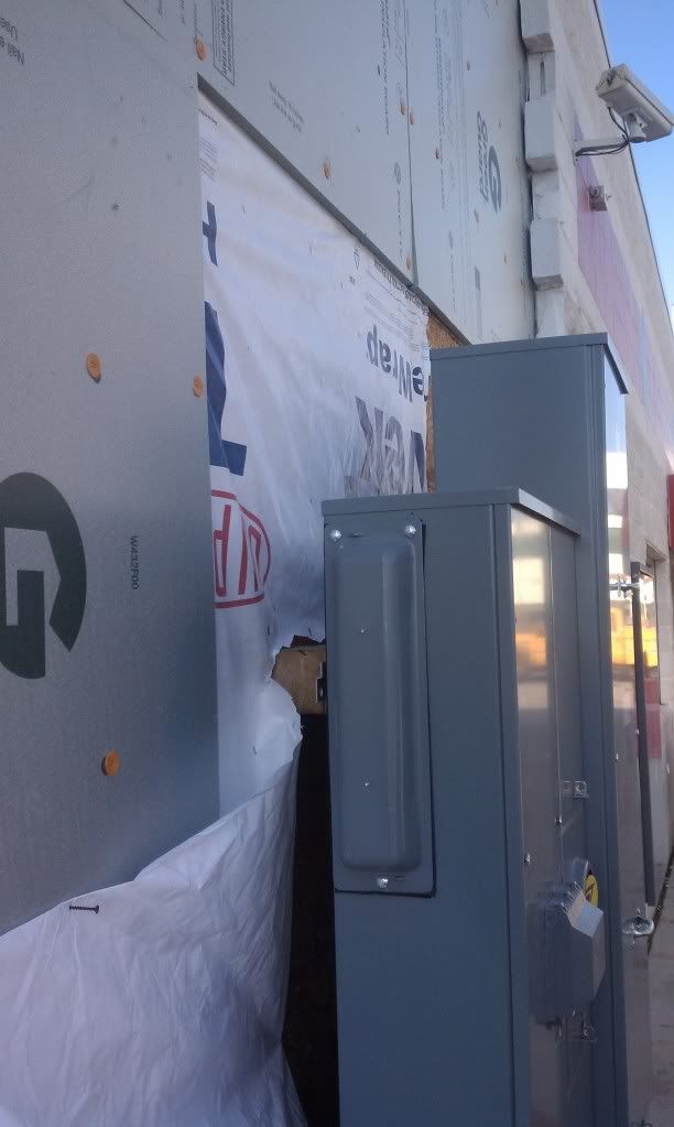

Not quite to plans, exterior coverings
13,000
Plans called for the Tyvek to be over the insulation board but that is not the only issue here now............................
Time to call in the
water resistant barrier; waterproof membrane; guy (tyvek it aint)
the masonry spacing guide guy
Begs the question though
What is the min airspace behind a masonry veneer?
Answer.
As wide as a masons finger!
