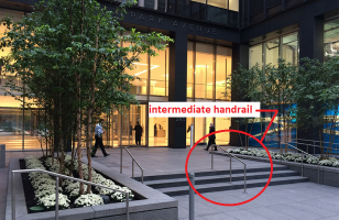

I'm working on an existing plaza project and we're redoing the stairs, redesigning a portion of the plaza as well. When I read this chapter, I'm not quite understanding, for example, If I have a 16'-8" exterior stair from the sidewalk level to the plaza level. How many intermediate handrails would I need?
