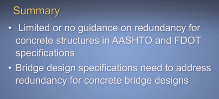

As engineering pushes the limits of design, we are starting to see the importance of the execution of the work. This bridge had no redundancy and warning cracks developed almost a week before the collapse. This is an education in construction and engineering management at many levels. Very, very tragic.

I had a book one, discussed about 2 dozens engineering disasters, and one common factor was lack of redundancy. I remember the kemper arena collapse in late 70’s ... kansas city? ... one roof bolt failed and the whole roof came down.

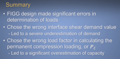

Yet more from the different NTSB evaluations. In this case the bridge design engineering firm use an unqualified, unauthorized peer review engineering firms to do part of it and then used another division within their own firm to do the other part of independent, peer review. They also used non-conservative calculations of 1.25 vs the conservative recommendations of .90.

WASHINGTON (Oct. 22, 2019) — The National Transportation Safety Board determined, during a public board meeting held Tuesday, that load and capacity calculation errors made by FIGG Bridge Engineers, Inc., are the probable cause of the fatal, March 15, 2018, Florida International University pedestrian bridge collapse in Miami.
Contributing to the collapse was Louis Berger’s inadequate peer review, which failed to detect FIGG’s calculation errors in its design of the main span truss member 11/12 nodal region and connection to the bridge deck. The FIGG engineer of record’s failure to identify the significance of structural cracking observed in this node before the collapse, and failure to obtain an independent peer review of the remedial plan to address the cracking, further contributed to the collapse.

  • FIGG’s bridge design was nonredundant because it provided only a singular load path.

  • Even if the cold joint surface of nodal region 11/12 had been roughened to a 0.25-inch amplitude, node 11/12 would not have had sufficient capacity to counteract the demand load for interface shear – and the bridge would still have been under-designed and could have failed.

Based on its investigation of the bridge collapse, the NTSB issued 11 safety recommendations in total, with one issued to the Federal Highway Administration, five issued to the Florida Department of Transportation, three issued to the American Association of State Highway and Transportation Officials, and two issued to FIGG Bridge Engineers, Inc.
