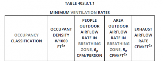

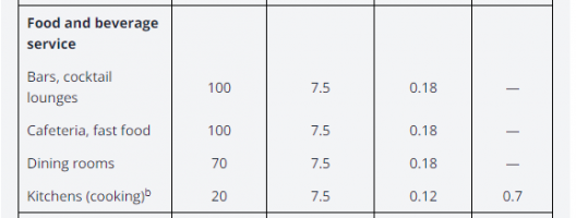

Ahh... well, that is very clearly the issue then. The cooking area clearly needs to have some exhaust. Not really sure how it was not provided. Even with the integral grease capture systems on the appliances, mechanical ventilation is required by IMC Table 403.3.1.1 at the following rates:
2021 IMC 403.2.1 Recirculation of air. ..... 1. Ventilation air shall not be recirculated from one dwelling unit to another or to dissimilar occupancies.
The mechanical code has it's own occupancy classifications separate from the building code for this very reason. The occupancies are listed in the ventilation rate charts and do not necessarily follow the building code M, B, R, H, etc. occupancies. You can't take air from a salon and recirculate it to a bank even though they are both B occupancies.
By the mechanical code a food service establishment like a cafeteria is dissimilar to an office space, even if it is accessory to it. ASHRAE 62, which the ventilation charts are based on, has categories for these occupancies based on contaminant levels.

These recirculating systems need to be listed to UL710B since they are in what I would consider a commercial kitchen. They would have a filtration system in them that needs routine maintenance. When these are used, each appliance under a recirculating hood adds 100 square feet to the general exhaust calcs from the ventilation tables in chapter 4. A 500 square foot kitchen with 4 appliances is figured at 900 square feet. At 0.7 CFM of exhaust per square foot, 630 CFM of general space exhaust is required.
