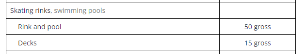

IBC 1004 has a pool deck occupant load of 15 sf per person which is translating into over 1000 people. The actual furniture (chaise lounges) accommodates around 150 people.
Counting the pool, I'm looking at about 1500 people, and I'm thinking A-5 is the closest occupancy for fixture counts, but the fixture counts are excessive IMO. Any thoughts on this? I feel like I'm always falling into grey areas with code...

The other confusing thing is that IBC Table 1004.5 does address outdoor pool occupancy loads at 50 gsf per occupant, which is giving me and occupant load of about 140 people inside the pool as opposed to the occupant load per ISPSC which is about 600.
