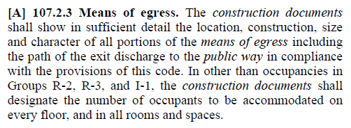

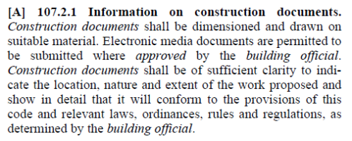

I would say they have to propose an occupancy and use classification. You can't even begin to review it without that information. You may decide that you don't agree with their proposed classification, but they have to propose one.
Without an occupancy classification, you can't review for allowable area, building height, or exit access travel distance. Without an occupancy classification, there's no way the constriction documents can "show in detail that it will conform to the provisions of this code ..."
