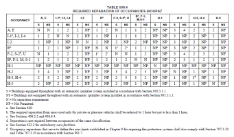

I'm changing the use of a tenant space from Group R to Group A-2. A fire sprinkler system will be installed, as the occupant load for the A-2 space is 180. The adjacent tenant space is Group B occupancy. The plan checker is requiring a 2-hour fire separation between the two occupancies, but based on my understanding, if a sprinkler system is provided, a 1-hour fire-resistance rating should be sufficient.

The fire-resistance rating is based on IBC Table 508.4 The first footnote states that 'S' means the building is sprinklered throughout. The question asked by e hilton is important. It sounds like you're trying to not do any work on the B side of the demising wall. If this means you are only adding sprinklers on the A-2 side, then the plan checker is correct -- you cannot use the fire-resistance ratings from the sprinklered columns.
You also can't mix and match components in U.L. assemblies. An assembly that was tested and listed with steel studs cannot be used with wood studs.
Footnote f sends you to 707.3.10 which also requires a 2 hr rating
707.3.10 Fire areas.
The fire barriers, fire walls, horizontal assemblies or combinations thereof separating a single occupancy into different fire areas shall have a fire-resistance rating of not less than that indicated in Table 707.3.10. The fire barriers, fire walls,horizontal assemblies or combinations thereof separating fire areas of mixed occupancies shall have a fire-resistance rating of not less than the highest value indicated in Table 707.3.10 for the occupancies under consideration.
