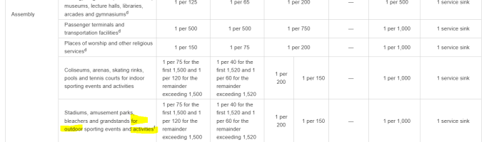

I have a park on the beach with parking. How do you determine occupant load when it comes to calculating plumbing fixtures? This appears to be a more AHJ specific answer.

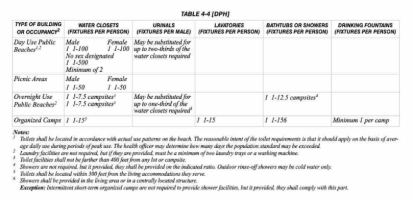

I realize it's hard to read, sorry. Footnote 1 says:
"Toilets shall be located in accordance with actual use patterns on the beach. The reasonable intent of the toilet requirements is that it should apply on the basis of average daily use during periods of peak use. The health officer may determine how many days the population standard may be exceeded."
If I were on the design team I would start with a "educated guess" on peak use, the look at where the bathroom facility is going to be located and what the budget is going to be. If it's going to serve 2,000-3,000 people in an ideal location with a 4" gravity drain and a million-dollar budget, then I'd draw up a nice facility, classic men's/women's plus a couple single-occupant (all gender), lavatories, etc., 18 toilets, 6 urinals, and I'm sure the AHJ would say "good job".
If the budget is $50-100k, I'd draw up a pair of good ol' outhouse's like this:
