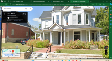

Replacing the front porch decking. contractor isnt giving much info and giving a bit of push back when asking for an engineer's letter or stamped plans.. luckily the homeowner is being awesome and getting an engineer's advice. 120 year old house.. not sure how that overhang is going to affect the home. there is also a little evidence of shifting/ sagging on the overhang and the porch decking... luckily i dont have to deal with the annoying contractor who has done it for 40 years and never had to have an engineered plan.. blah blah

Sorry, should have specified. they are replacing the column supports. and with the application, the contractor only specified temporary supports. the owner wants to re spin or refurbish the old columns
Ya, that’s what I was thinking on my first few looks at it.
My colleague tends to error on the side of caution. And I am fairly new at this.. so I do to. I wouldn’t have asked for it if the contractor would have actually given me detailed plans.. instead of “replacing existing decking and supports”

What overhang? Does the floor overhang or you are talking about the roof overhang? I don't see anything wrong with the porch roof overhang.
I could drive by and take a few photos. There is def some sagging.. can’t quite tell from google street view. But yea I’m speaking on the roof overhang. How it is attached to the house and the condition they are in is our biggest concern
If there's a permit for the floor, how does that get to existing roof to remain? Property maintenance code? Street view sure makes it look straight.
If you don't trust builder, it might make sense to look at framing and foundations when old decking is removed.

If the contractor would provide an As-Built Sketch to document what has withstood the test of time for 120 years, shouldn't the Prescriptive tables and guidance in the IRC allow you a basis to evaluate the Repair / Replacement?
If the FF is not greater than 30” above the adjacent grade within 3’, no permit could be required to build it from scratch.
