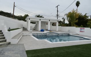

Here is a picture from the Poolsafe website. I don't see how the poles have been bonded. I sent an email asking how the poles are bonded. If I get an answer I'll let you know what they said.

I just got off the phone with a person from Poolsafe, a mesh fence co. My question was about the location of the fence in relation to the wall of the pool. Their website shows a mesh fence with metal poles about a foot away from the pool with no bond to the equipotential bonding grid.
I impersonated a customer in my first email inquiry, so this guy believed that. I was told that the code does not require bonding with an existing pool... I told him that he was mistaken. He disagreed and I then informed him that I am an inspector and I have a Los Angeles County Research Section bulletin on Poolsafe mesh fence that backs me up. I offered to provide him a copy.
He then stated that... Yes he has a copy of LA City and LA County bulletins that would require the bond but… they work in many jurisdictions that do not require that so there is nothing wrong with the picture at the website.
He was curious as to why I led him the think that I was a customer. I told him that I do that because so often if the company knows that I am an inspector, they ignore me.
In this case he gave a half truth to start then he went to a three-quarters truth with, "The fence is portable like lawn furniture. I asked him about the non-conductive screw. I wondered out loud if his patio furniture is screwed down. Then I silently thought, "Well he might live in Florida." With these situations I prefer to know the answer before I ask the question.
Did we reach a whole untruth when he said that the "other" jusisdictions don't require bonding? I would prefer to think that the other jurisdictions just don't know any better.

The website states that the fence is LA City and LA County approved with a flagrant violation in a picture.
