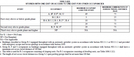

How about a 5,625 sq ft single story S-2 warehouse with a maximum 75 ft travel distance as permitted under the IEBC.
The building gets approved and built then the use changes and no review or permits for the change of use. It happens all over the world.
Table 1004.1.2 warehouse 1 occupant per 500 gross = 12 people, allowed one exit 29 people, 75 foot travel
remember the code is the legal minimum not best practice
2018 IEBC
TABLE 805.3.1.1(2)
STORIES WITH ONE EXIT OR ACCESS TO ONE EXIT
Maximum OL for an S-2 is 35 with a single exit
Under the legacy codes there was no common path of travel requirements and some occupancies where allowed 50 people before a second exit was required. Maximum travel distance in an exit access was 200 feet
1997 UBC
Warehouses permitted an OL of 30 before a second exit was required with an OL factor of 500 sq ft per person that is a 15,000 sq ft building with one exit. Uses change and exits should be added most definitely.
