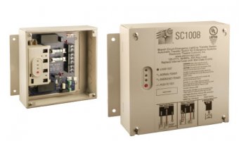

Figure 1. Branch Circuit Emergency Lighting Transfer Switch (Photo courtesy Electronic Theatre Controls)

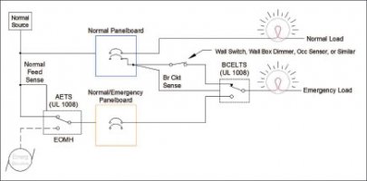

Figure 2a. Proper Use of BCELTS (Normal)

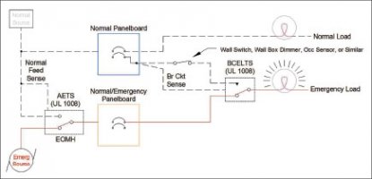

Figure 2b. Proper Use of BCELTS (Emergency)

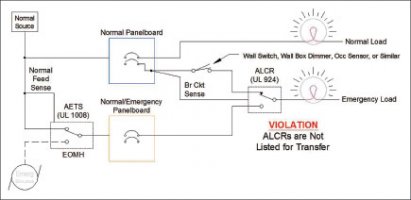

ALCRs are covered by 700.26 in the 2017 edition of the NEC and Listed to UL 924, Emergency Lighting and Power Equipment, under Category FTBR. Whether or not they appear to have transfer functionality, they are suitable only to bypass switches or control equipment fed from a single normal/emergency source, not to transfer between normal only and normal/emergency sources. The normal/emergency source must be provided via an upstream emergency transfer switch. See figures 3, 4, and 5.
Figure 3a. Improper Use of ALCR for Transfer Function (Normal)
