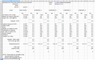

Here's a spreadsheet I've been using since Lotus was popular, but I can only post images, not Excel worksheets. Here's a screenshot of it.
