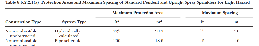

Something ain't right, according to NFPA 13. This is the most liberal spacing requirements:

Head coverages can deviate substantially from that table, so I would always recommend consulting the head specification for the actual area coverage. That table also only applies to standard upright and pendant systems, there would naturally be a lot of deviation for other systems.
