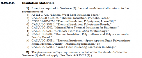

Fascinating issue at our office today.
One of our guys found the following product being applied in exterior walls:
This product doesn't meet the requirements of CSA S705.1, which is mandated by Part 9.
So strictly speaking, y'all can't use that for thermal insulation, as I see it.
Anyone aware of any guidances or supplemental testing that might make this work? I can't find anything, and my colleague delved into the CMHC testing database without finding anything of merit.

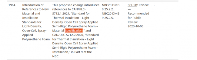

705 is just for medium density foams. This is a low density foam so 712 would be the appropriate standard for testing it.
The 712 standard is relatively new. Prior to this, each system was approved through an alternative solution approach.
Interesting that it is referenced in 9.36 as having an insulation value (Table A-9.36.2.4.(1)-D) but is not included in 9.25.2.2.
It looks like its exclusion from 9.25.2.2 might be an oversight in the code.

Indeed. FYI, there is no change in NBC 2020.
My position at this moment is that I would entertain a suitably crafted Alternative Solutions proposal.
