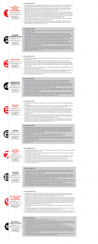

Top 10 cited violations as announced by OSHA at the National Safety Council's 2017
Fall Protection- general. ...
Hazard Communication. ...
Scaffolding. ...
Respiratory Protection. ...
Lockout/Tagout. ...
Ladders. ...
Powered Industrial Trucks. ...
Machine Guarding...
Fall Protection- training....
Electrical Protection....
