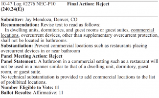

Overcurrent Protection Devices in Commercial Bathrooms NEC 240.24(E)
Not a substantial moisture load if there is not a shower....I get it....
(E) Not Located in Bathrooms.
Overcurrent protective devices, other than supplementary overcurrent protection, shall not be located in bathrooms, showering facilities, or locker rooms with showering facilities.

A restroom is a stupid place to locate an electric panel, but what danger does it create that it needs to be banned?
IMO, ...Commercial Restrooms should not have elec. panels
installed in them.........The potential for unauthorized access
is too high [ e.g. - vandalism, terrorism, curiosity leading
to damage, injury, other ]..........What if someone actually
needs to access the elec. panel in an emergency and the
door is locked, because someone is using the loo ?
