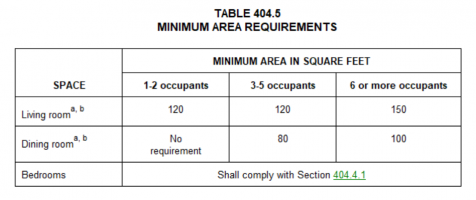

It would still be a single family residence. Notice the IRC does not have a minimum 120 sq ft for one room. This company recommends creating more bedrooms for more cash flow and one of the ways is to convert the living rooms into 1 or 2 bedrooms. The Property Maintenance code should prevent this if adopted
2018 Property Maintenance code
404.5 Overcrowding.
Dwelling units shall not be occupied by more occupants than permitted by the minimum area requirements of Table 404.5.
2018 IRC
R304.1 Minimum area.
Habitable rooms shall have a floor area of not less than 70 square feet (6.5 m2).
Exception: Kitchens.
R304.2 Minimum dimensions.
Habitable rooms shall be not less than 7 feet (2134 mm) in any horizontal dimension.
2018 IBC
1207.3 Room area.
Every dwelling unit shall have not less than one room that shall have not less than 120 square feet (11.2 m2) of net floor area. Other habitable rooms shall have a net floor area of not less than 70 square feet (6.5 m2).
Exception: Kitchens are not required to be of a minimum floor area.
