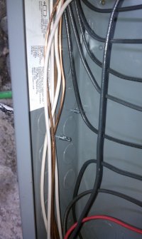

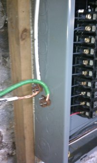

Panelboard screws
NEC 408.40 separate equipment grounding conductors shall be secured inside the cabinet.
