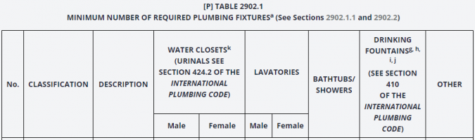

Was wondering if anyone had any insight on how to calculate plumbing requirements for an outdoor pavilion. Grill/seating is located under a structure, not enclosed, with enclosed restrooms also under the structure, and the patio/seating also continues out from under the structure (50% covered seating, 50% uncovered).
How would I calculate the loads to use in the plumbing calculations (would I include both covered and uncovered seating, basically entire patio area)? The space is functioning as a small grill (staffed) and gathering place for a country club, and they would use portable restrooms if they held any larger events w/ tents.
Thanks!

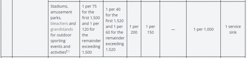

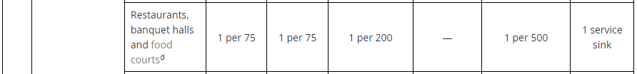

I'd calculate the OL as normal under the OLF from Table 1004.5; 7-net for concentrated chairs only or 15-net for unconcentrated table and chairs.
Then follow Table 2902.1 for determining plumbing fixtures. From Table 2902.1, the Classification fits as Assembly, with the Description most closely aligning with 'Stadiums, amusement parks, bleachers and grandstands for outdoor sporting events and activities' or with 'Restaurants, banquet halls and food courts'. See fixture counts as follows:
