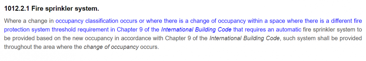

IEBC 1012.2.1 states: "Where a change in occupancy classification occurs......that requires an automatic fire sprinkler system to be provided based on the new occupancy in accordance with Chapter 9 of the IBC, such system shall be provided throughout the area where the occupancy occurs" (See snippet for unapplicable portion).

1) Within the (2) 10,000 sq. ft. separated areas, which include a Change of Use from S-1 to B., are sprinklers required?
Related Discussion Items:
a) [No sprinklers are required for the B offices themselves per IBC 903.
b) Due to the existing S-1, the change of use still occurs within a fire area where sprinklers would be required by IBC 903.2.9 (1).
c) Is it correct to read the verbiage of 1012.2.1 in combination with 1012.1.1.1 require the sprinklers?
d) Alternatively, is the general (IEBC 702.1) provision to make the building "no less safe" applicable here whereas the change from S-1 to B has actually made the building safer, or at least no less safe". (I would assume no because this is a change in use, not just an alteration, so additional requirements apply as noted above).

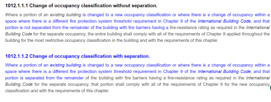

2) Per the verbiage in the commentary for 1012.1.1.2, it talks about providing occupancy separations per 508.4 to limit the extent of change-in-use requirements, including "...this shall also relate to exceeding the fire area..."
a) My understanding is that this would mean that sprinklers (if required in 1) would only be required in the (2) separated areas, but not the 3rd unchanged S-1 area. Do others agree?

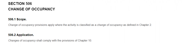

SECTION 506
CHANGE OF OCCUPANCY
506.1 Compliance.
A change of occupancy shall not be made in any building unless that building is made to comply with the requirements of the International Building Code for the use or occupancy. Changes of occupancy in a building or portion thereof shall be such that the existing building is not less complying with the provisions of this code than the existing building or structure was prior to the change. Subject to the approval of the building official, changes of occupancy shall be permitted without complying with all of the requirements of this code for the new occupancy, provided that the new occupancy is less hazardous, based on life and fire risk, than the existing occupancy.

1) Irrelevant. You can't sprinkler part of a building. You can install limited area sprinklers to protect specific, individual hazards, but a building is either sprinklered or non-sprinklered. A building that has sprinkler protection in half of the building area is an unsprinklered building.
1)d) B and S-1 are equal fire hazard.
2)a) See above. You don't sprinkler part of a building. Sprinklering part of a building doesn't get you anything nder the code.

1) Partial sprinklers are indeed an option, as the section 1012.1.1.2 specifically states that the changes only need to be applied within the separated occupancy undergoing a change in use, not the whole building, (unless otherwise required by another part of the code.)
For @mtlogcabin, what code are you reviewing that from? I'm looking at the IEBC 2015 and the (work area) 506 section is much, much less user friendly/lenient then the method you indicate. (As far as method, note too that this will be looked at under a work area method and Chapter 10, as Chapter 4 (prescriptive) isn't adopted in WI and performance isn't being selected due to other reasons.)
Thus I end up back at 1c) Is it correct to read the verbiage of 1012.2.1 in combination with 1012.1.1.1 require the sprinklers (IEBC 2015), or should only the "B" be looked at in this situation, ignoring all the existing use to remain/within same fire area?
2018 IEBC is what I posted. I see that was chapter 4 in the 2015 edition.
