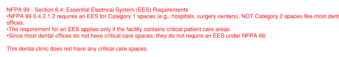

This dental facility has been declared to be a category 2 facility in response to my comments to verify the category by both the architect and electrical engineer. However in that same declaration they cite NFPA 99 6.4.2.1.2, which does not exist in any of the NFPA version since 2015, and where it existed prior to that was not applicable to their case. They use this citation to say that an EES is not required for a category 2 facility.
Per 99 4.3 the risk category must meet ch. 5 through 11, 14, &15 unless modified in those chapters.
Ch. 6: 6.5.1 requires a type 1 or 2 EES for a category 2 facility. (category 3 or 4 don't require an EES)
Ch. 15: Specific to dental facilities does not modify 6.5.1.
Based on the EE making the determination that it is a category 2 facility, I don't see why they think the code does not require an EES. Rather than repeat their response word for word I will paste it below. Basically they say since no critical care, no EES required. The code section they cite does not exist, but in general is correct in that an EES is required for category 1 facilities. What they fail to recognize (beyond the correct code reference) is 6.5.1, which DOES require an EES for category 2 facilities.
The architect provided a statement that it is a category 2 space, but that no sedation will be conducted, and there is no piped medical gas, only portable cylinders. This would seem to actually be a category 3 or 4 space, and not require an EES. But since they both declare it to be a category 2 I don't think I have a choice.
Am I missing something, or are they?
From the EE:
Maybe I have not had enough dental work, but I have not seen a procedure that would but me/ my health at risk if the power went out....At my dentist...
Just one of the reasons I think it is a category 3, but they insist that it is a category 2, but that an EES isn't required. I think they have two choices; correctly identify the facility as a category 3 with no required EES, or provide an EES for a category 2 they say it is. I will be having a conversation with them to see if I can see why they think it is category 2 and/or why they think they don't need an EES if it is.

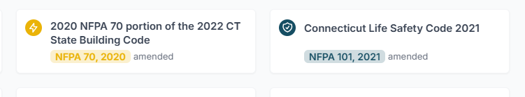

I am forced to use that a lot, but it is certainly not user friendly.
That's a feature, not a bug. It's designed to provide the minimal amount of public viewing that will prevent the federal government from whacking them over the head, while making it so painful to use that people will buy the standards rather than try to use the free portal.
Sort of.
UpCodes is able to do what they do under the legal principle that adopted laws and regulations are exempt from copyright protection and can bee freely copied and disseminated. UpCodes can't reproduce the model ICC code documents, and they can't reproduce the model NFPA documents. Anything you see on UpCodes is a version of the code or standard as it was adopted by a specific political jurisdiction. We can't go to UpCodes and find an unamended copy of anything (unless a code or standard was adopted by a jurisdiction without being amended).
In the ICC code books printed for my state's IBC and IRC, there's a double vertical line in the margin that informs readers where the code was amended by the state when adopted. I don't believe UpCodes in any way flags where the adopting amendments are located, so in looking at any code on UpCodes it's risky to assume that what you're seeing might apply in any other state, municipality, or jurisdiction.
