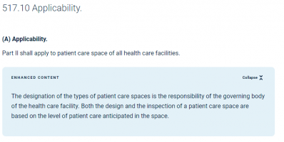

Does Part II of Article 517 of the NEC apply to patient sleeping rooms of nursing homes or limited care facilities where patient care activities do not involve the use of electrical or electronic life support systems; or invasive procedures where patients are electrically connected to line connected electromedical devices?

The official answer is no. Patient sleeping rooms in nursing homes such as the one described in the original post do not have to comply with Part II of NEC 517.
2023 NEC....I stand by my answer...IF they provide health care/ patient care some areas will be subject to 517...just depends on where...
Health Care Facilities.
Buildings, portions of buildings, or mobile enclosures in which human medical, dental, psychiatric, nursing, obstetrical, or surgical care is provided. [99:3.3.73] (CMP-15)

That is a formal interpretation by the NFPA, not an informal one. There is verbiage right in section II that clarifies the position of the formal interpretation. I will abide by the formal interpretation directly from the NFPA.
Jeff, I am confused....I posted the definition of health care facilities directly from the NEC.....? And here is patient care:
Patient Care Vicinity.
A space, within a location intended for the examination and treatment of patients, extending 1.8 m (6 ft) beyond the normal location of the bed, chair, table, treadmill, or other device that supports the patient during examination and treatment and extending vertically to 2.3 m (7 ft 6 in.) above the floor. [99:3.3.141] (517) (CMP-15)

The patient care vicinity is defined not only by the location of a patient bed but also by other equipment that supports a patient during examination or treatment. The vicinity is also determined by equipment in its normal location used for treatment or in the architect’s plans, rather than the temporary location of equipment subject to movement by housekeeping staff or for the convenience of the medical staff.

(B) Not Covered.
Part II shall not apply to the following:
  • (1)
    Business offices, corridors, waiting rooms, and the like in clinics, medical and dental offices, and outpatient facilities
  • (2)
    Areas of nursing homes and limited care facilities wired in accordance with Chapters 1 through 4 of this Code where these areas are used exclusively as patient sleeping rooms

I would have them spell out if they provide patient care in the "sleeping" bed or not....We don't necessarily disagree, (and I believe this was a new clarification to 2020NEC) but the word exclusively cannot be overlooked.....
