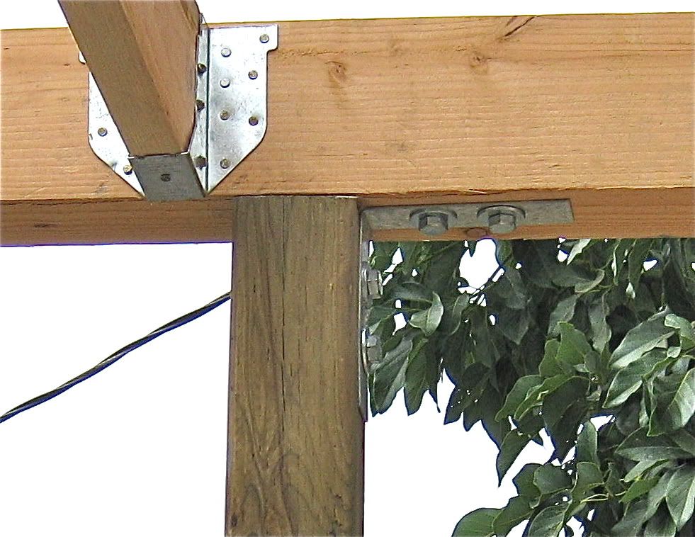

Notice the plumb cut on the rafters where they tuck in next to the house rafter tails. He did a nice job of it 16 times and then said screw it, I'm not going to H/D to buy another one. Yet again, an outdoor laundry.

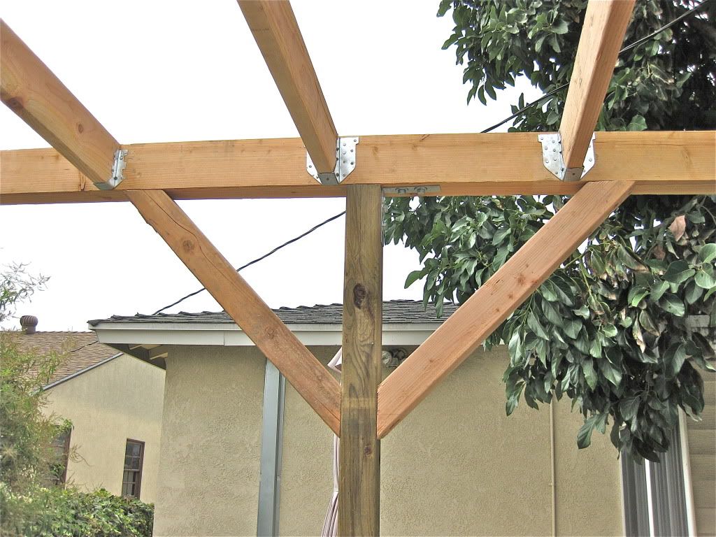

We provide them a handout drawing of a patio cover that we will accept. It is an easy to follow plan even if you don't speak English. It's when they start thinking that it goes awry.

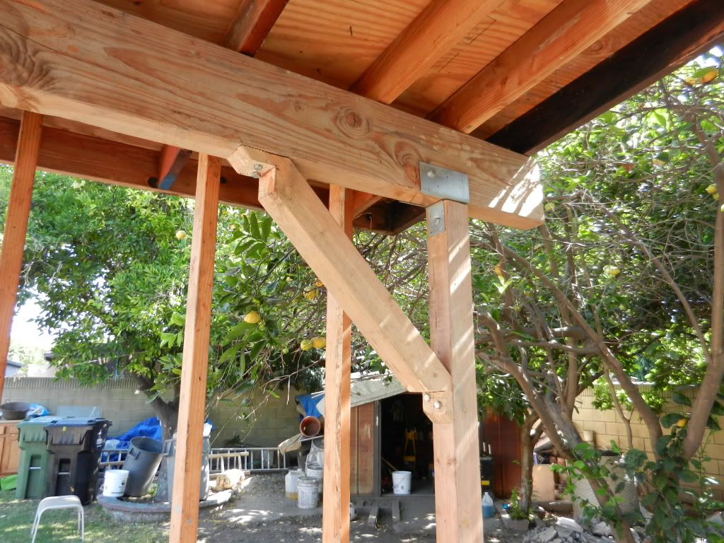

There are no nails holding the post to the header.
It looks old but it's 6 months new.

Picture 2 is damn crafty, bet that guy was pretty proud of those cuts.
It's a dinky patio cover and the post caps are stout so I said screw it, I'm not going to make you go to H/D and buy more 4"x4".

Why do you need nails when there is a bracket with lag bolts? What am I not seeing?
Secured only on one side?? As in if you push on from the picture side it might move??
You would have to be pretty damn strong to push against 2 lag bolts in the beam bracket and make it move.
