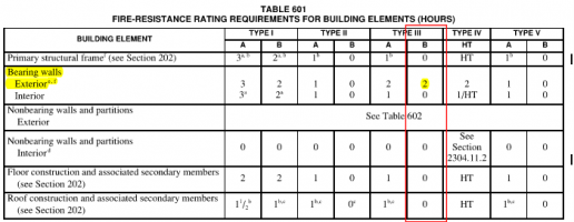

2018 ICC Code is enforced.
Can a pre-engineered metal building be classified as a 3B construction type?
The building would not have load-bearing exterior walls - no 2-hour rating required per Table 601.
The primary structural frame does not require a rating per Table 601.

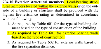

Does Section 704.10 influence the column ratings?

Although 704.10 isn't worded as well as you might like, that is what I have applied in this situation. I do not think the code intent is to allow a IIB building to be called IIIB just because they design the load-bearing elements to be just inside the exterior walls. Note that if you apply 704.10 in this case, 704.11 might be applicable to load-bearing beams. Given that the heights and areas for IIB and IIIB are usually the same, I assume someone wants to use wood for interior construction (mezzanine?) as allowed for IIIB.

IMHO, I have applied 704.10 to require protection of the primary structural frame columns in a PEMB where using Type III-B construction.

It seems to me that the intent is for the load-bearing frame to have 2 hour fire protection. If a steel column is located 2" inside a corrugated metal panel skin+channel curtain, it seems to me that column is acting as part of the exterior bearing wall.

I tried this argument once and was told in no uncertain terms that 3B didn't apply because the walls weren't load bearing.
If possible, the owner could de-rate this building to Type V-B.
However, if it needs to stay type 3B, that because the code is looking for some kind of extra protection afforded by 2 hour walls in exchange for allowing greater building area, height, or # of stories for a particular use.
I wouldn't buy it, but I've seen the argument that columns which are inside the girts are not part of the bearing wall thus don't have to be protected.
