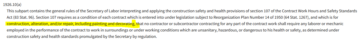

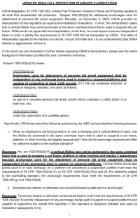

To paraphrase his email, this second personnel safety beam we have been adding on projects boils down to an OSHA fall protection requirement and not a building code requirement. OSHA regs 1926.502(d)(15), where workers exposed to a fall potential in excess of 10 feet (my recollection, it might be 6 these days) shall be tied off to a structure capable of sustaining shock loading of 5,000 pounds and shall NOT be used for suspending hoisted loads or platforms unless the fall protection can satisfy 1926.502(15)(i) and (ii).
OSHA doesn’t specifically state the means of tie off for the fall protection which could be accomplished in a number of different ways. In a CMU elevator shaft the easiest method being a small mason set steel beam. The elevator hoist beam CAN be used as a hoist / platform tie off and a personnel tie off as long as its designed to meet to loads and requirements of both uses. In the end its cheaper to add a several hundred dollar piece of 5”x5” HSS tube steel than to pay a structural engineer to run the calculations.
Since this is an OSHA requirement the building official does not have authority to enforce it. I would consider this a contractor means and methods issue. If the contractor wants to add a permanent member for this purpose the engineer could show a beam designed based on criteria provided by the contractor.
A shock loading of 5000 pounds will likely result in a larger member than required to support a 500 pound load.

...and shall NOT be used for suspending hoisted loads or platforms unless the fall protection can satisfy 1926.502(15)(i) and (ii)...
Seems to me that most hydraulic elevators use their hoistbeam only once, during initial construction. Thereafter, it has no ongoing function for a hoisted load, and the fall protection can be met with the hoistway beam.

OSHA 1926 is a standard for construction industry. One the building is built, it does not apply.
