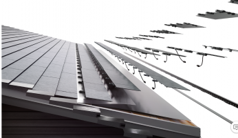

Tesla and a few other companies make a roof shingle that has an integral solar PV module. When you interconnect the shingles and run the appropriate wiring, the whole roof covering works as a solar array. My question is do they need to provide access paths to the ridge and setback from the ridge per 2018 IRC Section R324.6, or (as Tesla reps contend) is this product exempt because there is nothing above the roofline to present a tripping hazard.
PV shingles are called out in Section R324.5, and have to meet the requirements of R905.16 as a roof covering as well as the requirements in 324. R324.6 calls for pathways AROUND modules, but these shingles cover the whole roof and therefore access is THROUGH the module. Even though some shingles are active and some inactive, they are indistinguishable. I see no exception for PV shingles in R324.6.
I believe a change was made to the 2021 IRC that may resolve this problem, but I am not sure what the final code language says. In any case, that will not be in effect until 2022, absent a code modification approval to allow the use of 2021 code provisions now.
I would love to hear from other code officials who have either approved or rejected the installation of this product, and what your reasoning in.
PS - I am aware of the issue of Tesla solar modules catching fire far more often than the average PV module, which is related but distinct from this issue. I'm not sure if Tesla has installed their solar shingles in any states but California, perhaps because of this code issue. Maybe the California Building Code or state law has some workaround that allows this installation.

Yes, the same exception is found at 2018 IRC R324.6. But if the Fire AHJ does employ rooftop ventilation strategies, what then? How does a Tesla roof get installed without leaving 3' on each side and an 18-36" setback from ridge, depending on percentage of roof coverage?

A little off topic but I had a solar company tell me you can walk on their solar panel when I asked for a walikway to some skylights. I couldn't believe that, they said they only had 7% tilt and you could walk on them. I requested a new layout with walking space to the skylight to meet the code and they abliged.
I got to believe the Tessa solar tiles will include some dummy tiles on the rakes and ridge to meet code requirements for fire personal and service.
The only example that I’ve seen was a patch of solar tiles with Spanish clay tiles. I’m not sure what brand they were and they didn’t look like Tesla glass roofing tiles. There was no attempt at making it attractive.
Thats a nice looking installation. Of course they picked a nice one for the picture ... but it can be done.
