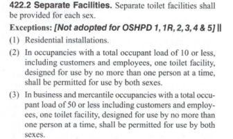

CPC has an exception allowing one single user restroom IF it is a business occupancy of 50 or less occupancy load. In my case, I'm looking at a cafe. My confusion comes with the following occupancy definitions: Assembly Group A-2 "restaurants, cafeterias and similar dining facilities" and Business Group B "food processing establishments and commercial kitchens not associated with restaurants, cafeterias and similar dining facilities not more than 2500 sq. ft." The comma has me confused.....are they saying that a cafe less than 2500 sq. ft can be considered B (a dining facility) as opposed to A-2.....and thus allowed the single user restroom exception? Thanks in advance.

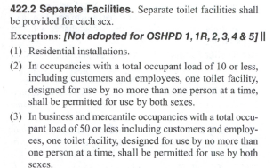

CPC 422.2 exception 3 confuses me. Using this cafe example, his small cafe is a B, and for discussion purposes, lets say it has an occupant load of 40 people. Per Table A, 20Men + 20Women. Table 422.1 tells me a need Men = 1 T + 1 Ur, and Women =2T and a lav in each. Does 422.2 exception 3 tell me that I only need one restroom with a single Toilet and Lav for the whole business? And it would be gender neutral in Calif......
If it is B occupancy with OL of 50 or less, one unisex toilet room can be provided. The single use toilet room must include one water closet, lavatory and urinal. Also it requires a floor drain.

Per CPC (UPC) Table 422.1, A or B occupancy requires minimum one urinal in addition to water closet, then floor drain is required per CPC 418.3 (3). Section 422.2 allows a singe-use toilet room for three conditions, but it does not eliminate the required number of fixtures.
I know it is odd. AHJ or Building Official may not require urinal and/or floor drain.
Do not agree with your interpretation. the exception 422.2 (3) indicates that a single toilet facility serving 50 or less shall be permitted for use by both sexes. I view this as an exception to the minimum plumbing fixture tables.
