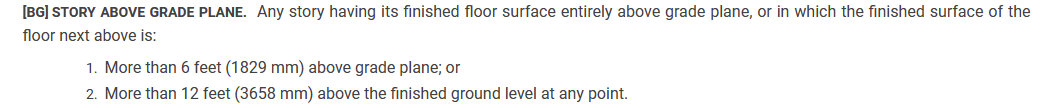

Gtyler. Others may have more experience on this matter. Here is a definition from the 22 California Building Code. I do not see how the grade plane would be altered to allow what you are discussing. It is all relative to the actual grade and finished ground level.

That doesn't nullify 510.2 at all. The Type III building starts at the top of the podium. By the definition of story above grade plane you can still build 5 stories of Type III. 510.5 is still as useless as it has always been; I've never seen that used one time.

Aaaaaahhhhh, the lightbulb just clicked... 504.4 doesn't say measured from grade, it's just referring to stories that are not below grade. Got it.
