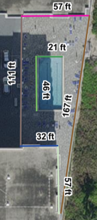

Let me clarify. This gate does swing out away from the pool. It is in a common area. There are 3 buildings that share 2 pools. Everything is outside.

Post #1 did not indicate the existing occupant load. IBC 1010.2.9 for Group A occupancies says that if the occupant load is 50+, then "panic hardware or fire exit hardware" is required in the direction of exit. The panic hardware may trigger an electric locking system (1010.2.9 exc. #2, 1010.2.11). The photo in post #1 does not show panic hardware.
IBC 1010.2.3 exception (and if applicable, ADAS 404.2.7 Exc. #2) does not allow self-latching door/gate mechanisms that are also self-locking by means of an electronic opener. This is true regardless of occupant load.
Here in California, Health and Safety Code 115923: An enclosure shall have all of the following characteristics:
(a) Any access gates through the enclosure open away from the swimming pool, and are self-closing with a self-latching device placed no lower than 60 inches above the ground.
So IBC 1010 would not allow an exit gate that requires operation of a FOB in order to activate the exit hardware latch. And if occ load is 50+, the hardware must be panic hardware.

Exits from the building are out the front and rear and one or two come out to the pool area.
When you are in the pool area and you go out of a required exit gate, does that path (A) lead you into the adjacent building before you exit discharge?
Or (B) do the gates exit discharge directly onto an exterior path that leads to the public right of way?
I did not do the math, but eyeballing it I'm guessing OL>50, so panic hardware required based on deck space.
