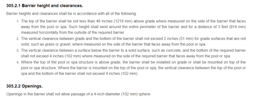

want to build a 14' x 12' deck leading to my pool I already have a deck off my house and want to step down pool deck off of this original deck.
1. do I need a barrier?/gate leading form the old deck to pool deck?
2. whats the height requirement for the barrier on the pool deck? I knowthe IRC states 48" above grade but is that from the ground or does my grade now start at the top of the deck surfaces?

You need to have a barrier that separates the grade and stairs from the pool that is at least 48 inches tall, has a gate the swings away from the pool is self-closing and latching, and the latch meets it's access requirements.
According to the 2015 international swimming and spa code requires the barrier to be not less than 48" above grade. It does not say 48" above a deck or a walking surface.
There is no definition of "grade" in this code or in the IBC or IRC but only the definition of "Grade Plane" which is the average ground level. In dictionaries it usually refers to the ground level or the angle of ground level
On the other hand the IRC and the IBC requires "guards" to be a minimum height from the adjacent walking surfaces.
305.2.1 Barrier height and clearances. Barrier heights
and clearances shall be in accordance with all of the following:
1. The top of the barrier shall be not less than 48 inches
(1219 mm) above grade where measured on the side
of the barrier that faces away from the pool or spa.
Such height shall exist around the entire perimeter
of the barrier and for a distance of 3 feet (914 mm)
measured horizontally from the outside of the
required barrier.

Hey Joshua I'm having the same issue with my deck I leave in ny and the inspector is telling me the 48" starts from the top of the deck I don't think is right but I would m.like to see what other people think
The 48" barrier is from the walking surface to the pool
International Pool and Spa code, Check for NY amendments
305.2.1 Barrier Height and Clearances
Barrier heights and clearances shall be in accordance with all of the following:
The top of the barrier shall be not less than 48 inches (1219 mm) above grade where measured on the side of the barrier that faces away from the pool or spa. Such height shall exist around the entire perimeter of the barrier and for a distance of 3 feet (914 mm) measured horizontally from the outside of the required barrier.
The vertical clearance between grade and the bottom of the barrier shall not exceed 2 inches (51 mm) for grade surfaces that are not solid, such as grass or gravel, where measured on the side of the barrier that faces away from the pool or spa.
The vertical clearance between a surface below the barrier to a solid surface, such as concrete, and the bottom of the required barrier shall not exceed 4 inches (102 mm) where measured on the side of the required barrier that faces away from the pool or spa.
Where the top of the pool or spa structure is above grade, the barrier shall be installed on grade or shall be mounted on top of the pool or spa structure. Where the barrier is mounted on the top of the pool or spa, the vertical clearance between the top of the pool or spa and the bottom of the barrier shall not exceed 4 inches (102 mm).
