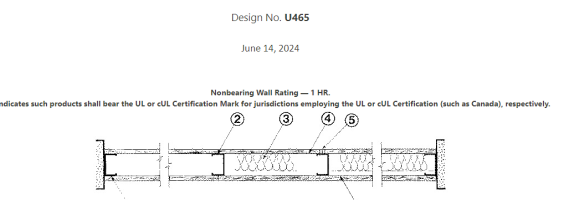

If you were aware that this was a post-tension slab high-rise, but the architect did not declare it on the plans for a remodel and gave details such as this, what would you do?
For the record, we return the plans, ask the design professional to declare whether or not the building is post-tension, and ask them to revise the attachment details. The attachment details change 100% of the time when it is a post-tension building. We are tired of having tendons snap because of attention-to-detail issues like this.

The architect called out a U465 assembly but didn't draw it that way.....I didn't say the rating was required because I don't know or care.....
Didn't they? Detail 2 clearly shows a second line, on the inside of the framing, for the insider layer of GWB, per the UL detail. :p
misaligned text, different sized leaders, different leader attachments, caps, no caps, incorrect scale... it hurts my eyes to look at those details too long
There is a line there, but the callout for the gyp board "clearly" only points to the outside of the soffit assembly. The extra line on the inside of the soffit is mystery material.
