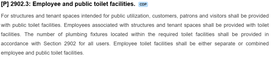

Privacy Added From Plumbing IBC 2024
13,320
[P] 1210.3 Privacy​
Public restrooms shall be visually screened from outside entry or exit doorways to ensure user privacy within the restroom. This provision shall also apply where mirrors would compromise personal privacy. Privacy at water closets and urinals shall be provided in accordance with Sections 1210.3.1 and 1210.3.2.
Exception: Visual screening shall not be required for single-occupant toilet rooms with a lockable door.
