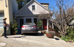

11B/ADA requires me to provide an accessible path of travel to a public right-of-way. I can connect my path to the public sidewalk, but the public sidewalk itself has a 7% main slope and a 1.5% cross slope. I can't see any scenario in which it is physically possible for a wheelchair to turn from private land and enter the 7% sloping public sidewalk without either violating a 5% maximum main slope or a 2% maximum cross-slope.
By way of analogy, here's how it's done with driveway aprons, but they are allowed to warp their transition at greater than 5% main / 2% cross slope:
What do you do when it's not a driveway, but a wheelchair path?
This place (below) just warped the private/public transition at greater than 2% - - I guess they just assumed it was the best they could do.
Unfortunately, it looks like that's about all you can do in a situation like that. Certainly not ideal but given that the municipal sidewalk exceeds the standards it would certainly be difficult for you to meet.
