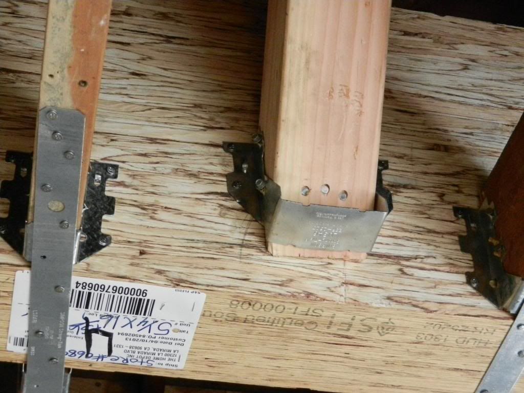

purlin brace
14,213
There are 16 just like it. Note the SDS at the sides. I gave it a D- for looks and a B- for strength.
THEY COULD HAVE USED THE PROPER HANGER
This one can be sloped up or down a maximum of 45°.
But, But, but....It's listed!!!!
You find the strangest things. I'd never get bored in your city, scared but not bored.
