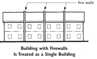

I am not clear in your post but FYI don't forget to look at Fair Housing and what they consider a single building. I remember something about all the dwellings being on one lot would require Fair Housing designed units but I can't find it now.
I am so old and been in this game way to long under way to many codes to trust my memory.
Buildings Separated by Firewalls or Covered Walkways Dwellings built within a single structure but separated by a firewall are treated under the Fair Housing Act as a single building. For example, a structure containing two units on each side of a firewall would not be regarded as four two-unit buildings (and thus not covered by the Guidelines) but as a single eight-unit building. In other situations where the dwelling units are connected, such as by stairs or a walkway that is structurally tied to the main body of the building, for purposes of the Guidelines, they are considered a single building and ground floor units in such buildings without elevators are covered.
Yup, I am researching FHA right now, I'll post what I find.
This situation is four separate and independent buildings with an eight foot gap between them. Each of the four buildings is a duplex.
We reached out to a representative from HCD and they said "...one- or two-family (duplex) dwellings, do not meet the definition of covered multifamily units, as such, do not need to comply with Chapter 11A. Chapter 11A applies to covered multifamily dwellings..." but then later said "...opinions issued are based on HCD’s published codes, and do not include any local or federal code policies or amendments..." so there's that. From my reading so far nothing in the FHA conflicts with this interpretation.
