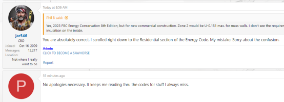

What code cycle is that for zone 2? Unless I am reading it wrong, Zone 2 in the 8th Edition of the FBC Existing 2023, the mass wall requirement is R4 or less than U 0.165. Providing more than half the insulation is on the inside.
Yes, 2023 FBC Energy Conservation 8th Edition, but for new commercial construction. Zone 2 would be U-0.151 max. for mass walls. I don't see the requirement for more than half of the insulation on the inside.
You are absolutely correct. I scrolled right down to the Residential section of the Energy Code. My mistake. Sorry about the confusion.
