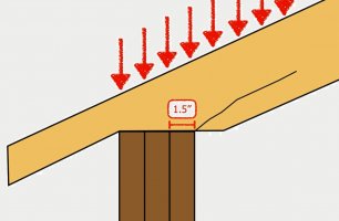

We have a residential builder in our jurisdiction who frames his roofs the old way with rafters, instead of using trusses like everyone else. So, when we inspect his projects, one of the main things we look at is the bearing of the rafters on the top plate.
So, we have written him up multiple times for having the rafters bear on the toe of the cut rather than the heel of the cut (see pictures). By cutting/notching the rafters this way, he reduces the depth of the rafters, allowing the rafter to split along the grain and greatly reducing the span of the rafters. This issue could be solved by using longer rafters and raising the roof a few inches to bear on the heel of the cut, or by changing the pitch of the roof slightly to bear on the heel of the cut, but the contractor does not like either option for complicated reasons.
The structural engineer he hired is telling him that cutting/notching in this way is a non-issue, which I can accept on a case-by-case basis, but I am not comfortable using that as a blanket rule of thumb.
Is there any way the pictures I am showing are a prescriptive method of rafter bearing or cutting/notching? How do other jurisdictions handle this?IMG_0664.JPGIMG_0665.JPGIMG_0600.JPG

The first pic is engineered lumber, so only an engineer can approve the notch as the manufacturer won't....Non-prescriptive and fails at least two code sections..

So, I was always told that bearing on the toe of the cut and not on the heel is non-compliant, but what code section says that rafters have to have full bearing? I'm kind of stuck for a code section that specifically addresses this problem, I have been using R801.2 (Roof construction need to be strong enough to support all the loads), and 806.2 just says that the ends of each rafter shall have 1 1/2" of bearing.
All of the pictures shown have 1 1/2" bearing, just not where it supports the full rafter.

A roof I-joist is cut that way and they attach to the top plate and add web stiffeners.
I'm not finding anything that shows the connection without a birds mouth cut. Bearing should be a minimum of 1.5" as you noted.

Try R502.8, look specifically at R502.8.1 for sawn lumber and R503.8.2 for engineered wood. They reference that all cuts, notches & bored holes for joist, rafters & beams shall follow these code sections
Ask him for a calculation showing that the shear capacity of the hip is adequate at the bearing point.

Since the roof sheathing is already on I don't see how he will install ceiling joists to act as ties. Therefore the hip is acting as a beam. I often specified LVLs for hips because the moment with a 20 PSF live load was too much for a 2x12 once the hip length reached 16 ft.
We don't know the span of the hip rafters, the tributary loads, nor the minimum nominal dimension required. So if the building oversized the hip rafters to allow for the cuts, say using 2x10 where a 2x6 is only required, then would you allow it?
I would feel better about it, but I would think it would be similar to a builder ripping a 2x10 down to 2x6. It would probably work, but wouldn't it void the stamp on the lumber? So then are you using unstamped lumber? Which would have to be engineered anyway?
I accept that in the field sometimes, when a 2x6 is required and they still had more than the nominal 2x6 dimension, but I don't know if it is technically permissible.
The stamp on the lumber is specific to the grade, it does not regulate the cutting of the lumber. If a No.2 DF 2x10 were reduced in dimension, the grade is still the same. As for removing the stamp, if the inspector is wanting to see the stamp, be sure to cut so as to leave it on the rafter. Or be sure to safe the pieces with the stamp to show the inspector. The Building Official is the one who has ultimate decision on the matter. (R104.11)

We don't require bearing details for rafters in plan review, so if rafters are shown on the prints it is assumed that they will be installed in accordance with R802.7.1. The inspector gets to the field, sees that it does not comply with R802.7.1, and writes it up. The engineer is hired, he comes in and looks at it, he provides us with a letter stating that the rafter can support all loads as required by the building code, we approve it and move on. Rinse and repeat. It is still going on to this day.
