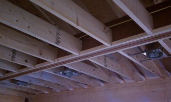

That looks like any of a hundred frame jobs I have seen...and failed back in the day. Lots of engineering solutions have been come up with after the fact, many some variation of the strap steveray shows. I encountered this very heavily in the rural south, and saw more than a few failures where the exterior walls were blowing out. Very common in "bonus room" framing which is usually made worse by using knee walls at the exterior. Once demonstrated the issue to a builder (on a very nice home) by having him help me measure across the room at the bottom and the top plate. I asked him if he purposely installed the knee walls several inches out of plumb. This was made very apparent by the "temporary" t-posts they were using to hold up the ridge board. It was bowed so badly the nails were bending at the connection.
In Jar's photo a flat strap across the bottom would do it, but might ruin the finish product. Also, I rarely have seen ledger framing outside of the south, which makes a nice finish, but the ledger nails look a little far apart.
I don’t see the problem. Looks like 3 toe nails from the joist, part way into the beam web … we always do it that way …

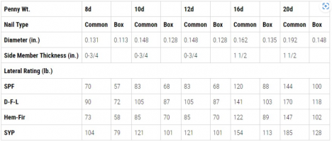

3-16d is about 360# in shear if I remember....So lets call it 400# these are not giant forces we are dealing with....The flat strap under is a problem for the drywaller ...
Sorry...mis-clip.....at 30# load and a 7 pitch or steeper, it's about the same (what's a 16d or 2 amongst friends..Not that anyone builds with 16ds anyway, so it probably has 10 10ds....And kind of moot as once again...It's all trusses per the energy code around here now...

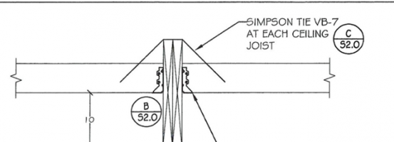

I recommend a Simpson VB-7...but it is way overkill, but you can point to it in the book, so it is easy.......You are looking at controlling about 400# if you are using the prescriptive nail connection...
Screenshot 2023-08-21 at 10-23-08 C_VB10_2DP_Cad_ISO_Instld.dwg - C_VB10_2DP_Cad_ISO_Instld.pdf.png
Never seen this used. Usually see CS-22. Almost always specified by an engineer. The dry-waller can work around it.

Referring to the ledger nails. I had it in my head that they should be closer, but the current codes don't give a dimension, and the code I thought they exceeded calls it 4" o/c, so these are probably fine. Ledger framing provides a much better finish, produces less squeaks, and is cheaper and quicker. JMHO.
Jar, are there any collar or rafter ties above the CJ/Beam connections to prevent spread?

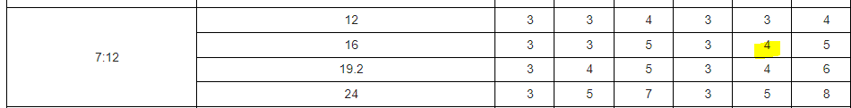

You mean this?
Yes. Back in the day in another state with a state code, they prescribed it in this table and I guess I mis-remembered it as "within 3" of the joist, so one nail under and 2 or 3 within 3" of the joist. But, I went back and can only find that it says 4" o/c. It may have come from an earlier edition, or it may be that I have been wrong all along, and current code has no distance prescription anyway with "At each joist".
