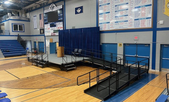

Temporary Platform, Temporary Ramp
"...ramps serving temporary structures can be temporary or portable."
