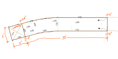

Looks good from here the code does not say the maximum run is 30ft, its that the maximum rise is 30-inches between landings, so a ramp at 1:16 will be longer than 30ft, the length does not matter.I have a ramp with a slight bend in it between landings. Max rise is 30", max running slope is 1:12, and cross slopes are under 2%. Please see sketch below, railings not shown. I believe this is compliant, agree?
Thank you! I will give them some wiggle room on the slope.It meets ADA. Here in California we would have longer landings, but the slopes and the bend comply - - on paper.
As a practical matter, it is extremely difficult to construct a ramp at exactly 8.33%.
