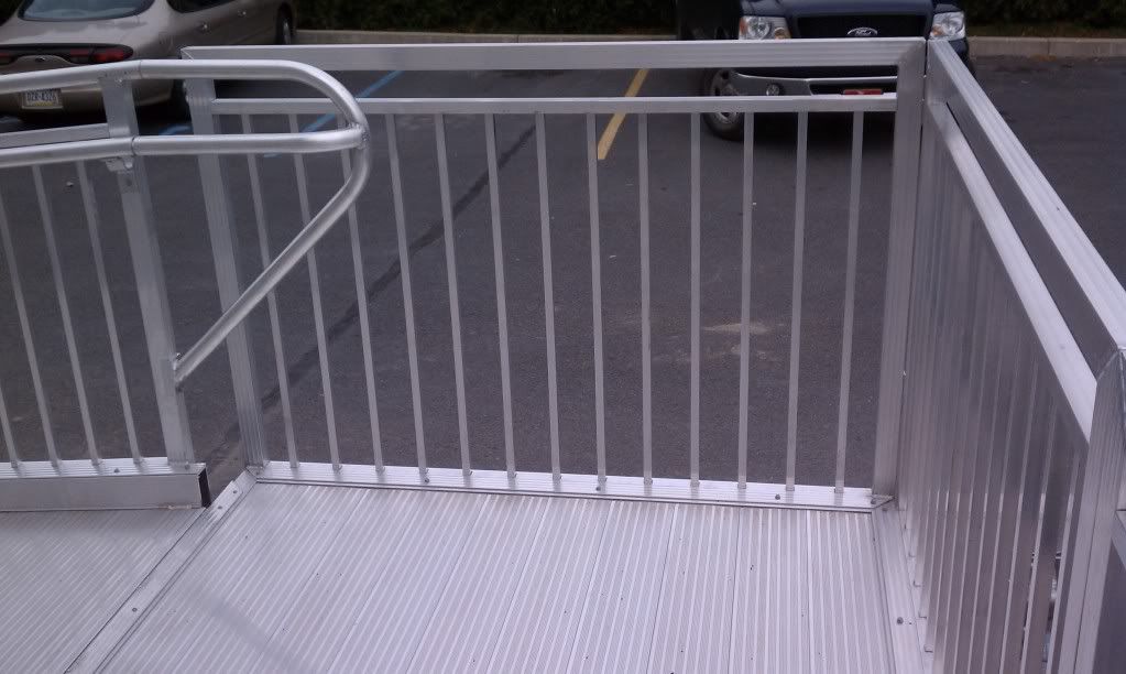

What is the verdict on this one?
Not compliant with ANSI 117.1 (505.3)
403.5.1 is Not applicable to ramps
405 governs ramps
405.7.4 Change in Direction.
Ramps that change direction at ramp landings shall be sized to provide a turning space complying with Section 304.3.
304.3 Size.
Turning spaces shall comply with Section 304.3.1 or 304.3.2.
304.3 require a 60" turning space

Here are the core things I pickup on, don't have a book in front of me, but from memory.
1. Since you can't have a ramp run more than 30' I am guessing that the bottom ramp run is less than 30" high to the mid landing. Hence check Width between handrails, curb at bottom, no guard needed for this portion unless height is over 30", not sure about the change in materials at the lower landing, but questionable.
2. As noted by others the mid level landing size seems small <60, but no tape measurement notes, if the landing is still under 30" no guard needed, handrail on outer side seems to extend 12" past not sure though, inner leg wraps around 180 degree landing to upper ramp run seems compliant, but not real sure of the funky fitings used.
3. Upper ramp run, again not sure about height from ground level below, but this looks like it extends more than 30" thus guard requirements kick in for 42" high 4" sphere, yada yada yada, lower handrail extensions look to be compliant except the inner legs fittings?????
Upper terminations of the handrails looks like the outer leg is not terminated corectly for the extension.
4. Now with all that said I am sure there are other things like the 2 strand pipe guard on the upper landing, but I guess thats existing??????
5. Not sure about the height of the handrails nor loads, but an engineers sealed drawings for loads should tell you, that information.
I am guessing the rest of you will add, but these are the questions I see just from the picture, things I would question.
Guards are required if at any point is above 30". So if the highest landing is above 30" the whole stairway needs guards.
I thougt that less than 4" opening was so kids wouldn't get their head stuck in the guard. If this is so why does it matter how high the floor is to require less than a 4" opening.
1. Guards are not required in ANSI A117.1 only handrails,
2. Only required guards are required to meet the 4" sphere requirement, so non-required guards are not required to meet 4" sphere even if there in place, per IBC 2006 & 2009.
3. Height of guards in place under 2006 could be considered to require compliance, however 2009 only requires required guards to comply.
4. The code does not say in the IBC that if any part is over 30" all must comply, it only reads in the IBC that when the drop is more than 30" a guard is required for that section over 30".
You might be thinking of the old IRC 2000, 2003 & 2006 which is no longer in the 2009 IRC. But IBC is not that way nor the 2009 IBC.
Example how many times do you see the first portion of a ramp with 2 strand pipe and then the upper half with guards and handrails.
But all or nothing is not in the code.

Here are my comments. Some are ridiculous, but that's what the code says.
Violation? Non-compliant ramp. Why? Because I said so. You can't do that. Well, I've been writing violations like this for years.
Seriously now:
Second Picture
- IBC 1013.3 Looks like a 4" sphere could fit between the ramp guard/railing section and the landing guard/railing section.
Third Picture
- ANSI 505.6 Is the pipe elbow fitting considered an obstruction or is this just a continuous handrail that changes size?
- IBC 1012.2 Handrail height cannot change. The pipe fitting results in a change in height.
- ANSI 405.10 Landings subject to wet conditions shall be designed to prevent the accumulation of water. Looks like this may inadvertantly collect water. How much is too much? The code doesn't say. Dump a bucket of water on it and see how bad it is to walk / manuever a wheel chair on.
Last Picture
- ANSI 505.10 The handrail on the right needs to extend 12" onto the landing or be continuous with a handrail on the landing. Maybe this is OK if you approve exception #3, hazardous in an alteration.
- IBC 1013.3 Looks like a 4" sphere may fit between the new and old railing sections.
Far stretch:
Third Picture - IBC 1013 There are approximately (2) 2" sections missing between the round guards on the ramp runs and the rectangular metal joining the two portions of the landing. Someone might fall off in those 2". :roll:

Jeff,
MEch, cover most of the points and I would only add the following,
1. What was submitted on the drawings? Does it match what is installed, if it does and complies, then I would say you are limited to having them remove the odd sized handrail fittings and replacing with equal size and flow. This is a call on your part if you believe these fittings are obstructions and thus not allowed.
2. At the top of the upper ramp the 12" extension is covered under the exception rule, however, I would request that it be turned 90 degrees and run 12" just to allow the extension to be there, but not extend out in to traffic. This was your question on the post under the pictures.
3. I am not sure why but during the print review, the existing 2 strand pipe guard was not flagged and required to be closed in and meet the new code requirements, I am not sure, but here that would not have been exempt from being upgraded because the upper landing of the ramp must comply with the ramp. The adding of the ramp added this area to be required and in to play at least for the 60" x 60" required area.
4. As for the large openings in the guard at the mid landing to ramp locations if over 30" above the grade below, require be closed down to the 4" sphere. The height of the guard looks to be correct, but check the opening in the top as the 2009 IBC reduced that opening from 8" sphere to 4-3/8" sphere.
Other than that, all the other items of note by others IMO should have been covered under plan review before it was built.
