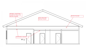

I'm working on a single story, 4,000 sf oral surgery building that will be sprinklered and Type VB.
There will be suspended ACT ceilings below the prefab trusses of the gable roof. The plan is to put drywall on the underside of the bottom chord of the trusses to create a return plenum. See my attached concept section drawing.
Does the drywall at the bottom of the trusses need to be rated, therefore creating a rated attic?
BTW, the attic is not accessible, and I am planning on draft stopping there, per 718.4.
Thank you for the help.
If the drawing is an accurate representation, there will need to be access to the attic. You should ask the truss company about adding the weight of drywall to the bottom chord.
Might need sprinklers in the plenum area.
I will provide for access into the attic and ask about that added weight. Do you think the drywall needs to be rated, therefore creating a rated attic? And where would I determine if the plenum needs to be sprinklered separated?

I do not think that the drywall would need to be rated... mostly because i don't think that drywall is rated... an assembly is rated. I would use type-X just because I could. The plenum area is a concealed space so I would presume that it shall have sprinklers... note that earlier I said "might" need... but I am not the person to ask about any of this.

Help?....Well here you go then, you don't have to draftstop the attic when you install an NFPA 13 system:
718.4 Draftstopping in Attics​
Draftstopping shall be installed to subdivide attic spaces where required by Section 708.4.2. In other than Group R, draftstopping shall be installed to subdivide combustible attic spaces and combustible concealed roof spaces such that any horizontal area does not exceed 3,000 square feet (279 m2). Ventilation of concealed roof spaces shall be maintained in accordance with Section 1202.2.1.
Exception: Buildings equipped throughout with an automatic sprinkler system in accordance with Section 903.3.1.1.
903.3.1.1 NFPA 13 sprinkler systems. Where the provisions of this code require that a building or portion thereof be equipped throughout with an automatic sprinkler system in accordance with this section, sprinklers shall be installed throughout in accordance with NFPA 13 as amended in Chapter 35 except as provided in Sections 903.3.1.1.1 and 903.3.1.1.2.
