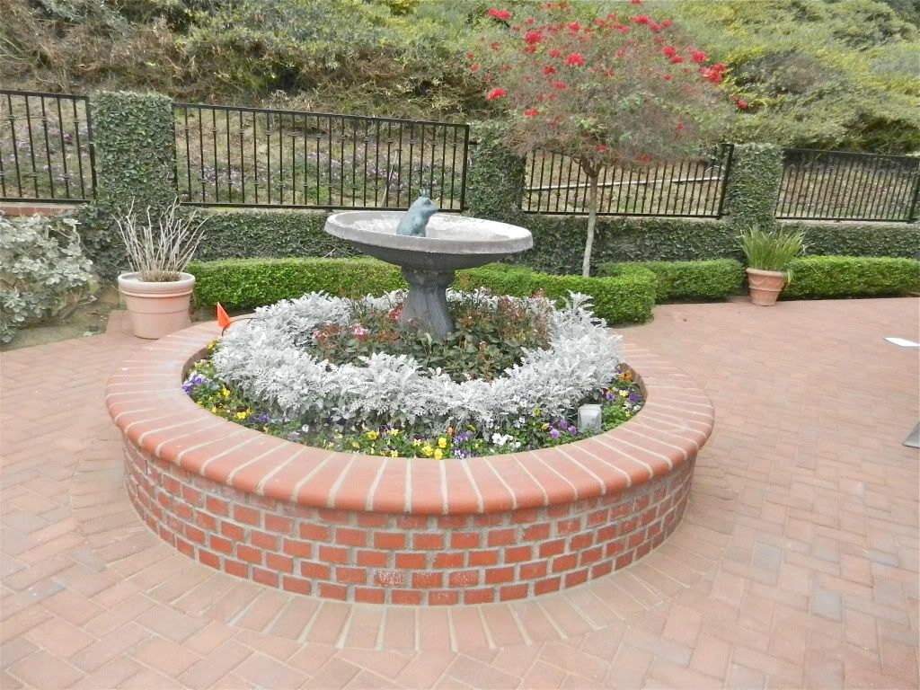

What code section would prevent a receptacle from being located in a planter that could be flooded?

Receptacles can be installed in fountains.......They just have to use
the correct type of conduit, wiring and receptacle for this type
of application........Also, [ as Dennis stated ], an "in use" type cover
must be installed. [ RE: Article 680, `08 NEC ].

If the receptacle and cover were any higher, then it wouldn't look as
purdy as the flowers, ...and you know all too well, that they ain't
gonna let safety get in the way of their faint-see flower fountain.
"Safety, ...schmafety !" :D
I hope you jest, ICE. I'm all for aggressive pursuit of code compliance. But if any of us start enforcing personal preferences - it makes us all look bad.
We call it Joe Code around here. It usually surfaces around workmanship, or interpretation, issues with contractors who like to brag how they build everything to code. Regardless, there are a lot of different justifications for it, but it still isn't in our adopted "minimum" codes, and not something to be enforced. Every year we review these issues with other contractors, designers, and code officials to see if an amendment should be considered. Last time we did that was for sump pumps. We kept getting a contractor who would relocate the line to discharge into window wells. Nothing in the code that we could find to prohibit it, so amended our codes. Hasn't been an issue since.

Yeah, It is a fine line where you have to convince someone to do this in a better way. It doesn't even look like a fountain but if the outlet is for that I would have tried to locate it under the base or closer to the bird bath....
