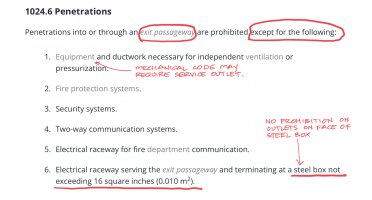

It is a permitted penetration in the U.S. if it doesn't exceed 16 square inches in area (a standard 4" x 4" steel box). Another difference between the ICC and the Canadian NBC.
1023.5 Penetrations. Penetrations into or through interior exit
stairways and ramps are prohibited except for the following:
1. Equipment and ductwork necessary for independent
ventilation or pressurization.
2. Fire protection systems.
3. Security systems.
4. Two-way communication systems.
5. Electrical raceway for fire department communication
systems.
6. Electrical raceway serving the interior exit stairway
and ramp and terminating at a steel box not exceeding
16 square inches
(0.010 m2).
7. Structural elements supporting the interior exit stairway
or ramp or enclosure, such as beams or joists.
Such penetrations shall be protected in accordance with
Section 714. There shall not be penetrations or communication
openings, whether protected or not, between adjacent interior
exit stairways and ramps.

My answers, based on the IBC (not Canadian codes):
1. Yes
2. Yes
3. Yes
4. Any cabinet, wall gung or inset would not be allowed to penetrate membranes that are part fo the fire-rated assembly. I typically see semi recessed cabinets installed with drywall behind them to maintain the membrane.
5. Yes, plastic boxes prohibited.
