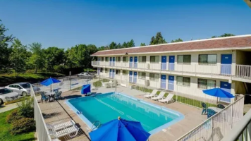

I think the low-hanging fruit in California would be related to Project Homekey, the reuse of underutilized motels as homeless housing. Changing the length of stay to from transitory to longer than 30 days is treated as a change of occupancy, which then triggers a bunch of facility upgrades.
In older versions of the code, hotels and apartments were treated as the same occupancy, and changing the length of stay did not trigger change of use upgrades.
Yup, I've permitted two home-key projects here and they were both pretty straight forward. The hardest thing to convince the contractors and owners of was yes, you do have to have a separate kitchen sink in the kitchenette area, the bathroom lavatory can't serve as both. "But it's outside of the bathroom". Sorry, don't care, follow your approved plans.
The other one had to add sprinklers, but they didn't complain one bit, they said even if I didn't require it their insurance would have anyways. That particular project has already had two separate units completely destroyed by fires. The sprinklers kept it contained to the one unit, and the alarm had the FD there in less than 10 minutes each time.
