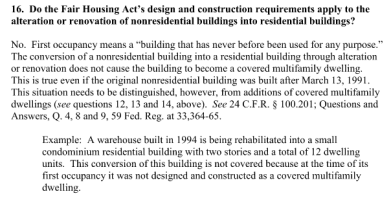

The HUD Fair Housing Act would apply if there are 4 or more dwelling units.
If the new dwelling units are being created via altering the existing building (not by creating additional/new square footage), then FHA would not require the new (privately funded) units to be accessible. See the excerpt below from the "Joint Statement" (Q and A) by HUD and the DOJ:
The OP did not state where the building was located, the applicable codes, era of original construction, public vs. private funding, etc., so any information we provide regarding the dwelling is based on speculation.
