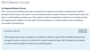

(A) Required Branch Circuit.
Each commercial building and each commercial occupancy accessible to pedestrians shall be provided with at least one outlet in an accessible location at each entrance to each tenant space for sign or outline lighting system use. The outlet(s) shall be supplied by a branch circuit rated at least 20 amperes that supplies no other load.
Exception No. 1:
A sign or outline lighting outlet shall not be required at entrances for deliveries, service corridors, or service hallways that are intended to be used only by service personnel or employees.
Exception No. 2:
The required branch circuit shall be permitted to supply loads directly related to the control of the sign such as electronic or electromechanical controllers.
This requirement is not contingent on whether an electric sign will be installed at the time an occupant moves in, since it is common to install an electric sign after the space is occupied or when a new occupant moves into an existing space.

600.5 Branch Circuits.
Each commercial building and each commercial occupancy accessible to pedestrians shall be provided with at least one outlet in an accessible location at each entrance to each tenant space for sign or outline lighting system use. The outlet(s) shall be supplied by a branch circuit rated at least 20 amperes that supplies no other load. Service hallways or corridors shall not be considered accessible to pedestrians.
