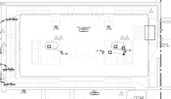

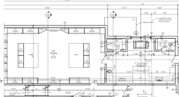

Not all homes are traditional. In the case below, this walk-in closet is several hundred square feet and includes two islands used for ironing, steaming, and preparing clothing. Do you think that receptacles were planned for these islands because they made sense or because they were required by code?

We’ve been debating whether receptacles are required in islands located inside large walk-in closets just because they have a countertop and might be considered a work surface. Here’s what the NFPA 70, section 210.52(C)(2) says:
“Receptacle outlets, if installed to serve an island or peninsular countertop or work surface, shall be installed in accordance with 210.52(C)(3). If a receptacle outlet is not provided to serve an island or peninsular countertop or work surface, provisions shall be provided at the island or peninsula for future addition of a receptacle outlet to serve the island or peninsular countertop or work surface.”
Also, here’s more from section 210.52(C):
“In kitchens, pantries, breakfast rooms, dining rooms, and similar areas of dwelling units, receptacle outlets for countertop and work surfaces that are 300 mm (12 in.) or wider shall be installed in accordance with 210.52(C)(1) through (C)(3) and shall not be considered as the receptacle outlets required by 210.52(A).”
So, here are my thoughts:
The main intent of 210.52(C) is to ensure areas like kitchens, pantries, breakfast rooms, and dining rooms have enough receptacle outlets for appliances and other electrical needs. These are the areas typically associated with food preparation and related activities.
Now, a walk-in closet with an island and countertop doesn’t naturally fit into these categories. Walk-in closets are used for clothing storage and dressing, not for food prep or similar electrical needs. While the code does mention “similar areas,” a closet doesn’t seem to be what they had in mind.
The term “work surface” in this context is likely referring to surfaces where food preparation or similar activities occur. An island in a walk-in closet might be used for folding clothes or organizing accessories, but that doesn’t align with the typical activities envisioned by the code for “work surfaces” in kitchens and dining areas.
From what I’ve seen in the industry, most interpretations and applications of the NEC align with the specific use cases mentioned in the code. Receptacle requirements in walk-in closets are generally governed by other sections of the code that address general lighting and convenience outlets in habitable spaces.
After consulting with some electrical inspectors and other pros, it seems there’s a consensus that walk-in closets do not fall under the requirements of 210.52(C) for countertop and work surface receptacles. The intent of the code is safety and functionality in areas where significant electrical use occurs, like kitchens and dining areas, not closets.
So, based on the code language and typical interpretations, receptacle outlets are not required on islands or countertops in large walk-in closets just because they might be considered a work surface. If there are specific local amendments or interpretations by your AHJ, it’s always good to check with them for a definitive ruling. But from a general code perspective, the requirement doesn’t extend to walk-in closets.
