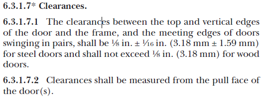

If the corridors require a fire-resistance rating, the doors have to be rated fire doors. The size of the perimeter gaps (all four sides, not just the bottom) is regulated. The NFPA standard for fire doors is NFPA 80. The most recent version I have is 2013, but I don't think the edge clearances have changed.

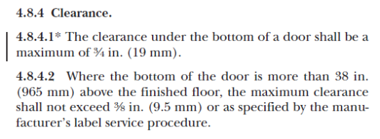

I thought I remembered the maximum clearance at the bottom as being 3/4-inch, but I don't see the bottom clearance as being addressed in my 2013 copy of NFPA 80. I may be remembering standard spec language from AIA MasterSpec.
No, I found it:
Thank you for finding that, YC - I had a plan check comment that stated it was in NFPA 80 but they didn't provide anything other than "NFPA 80".
